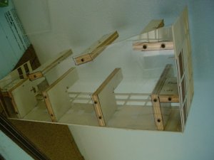

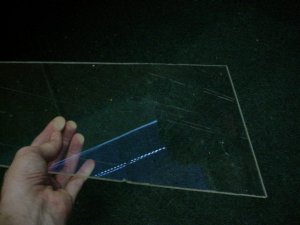

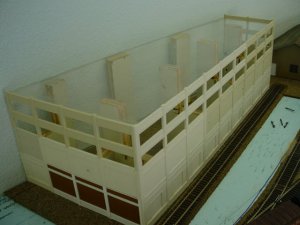

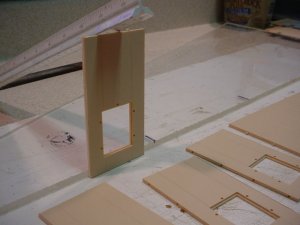

    Here is something that may or may not be of use to you. For my larger structures, I have been using plexiglass. It just so happens that I am starting a new structure today. Here are 2 photos, plus 2 more photos of another building I started a few weeks ago.
