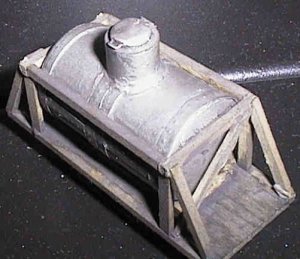

Mike, I made these tanks out of dowelling 1 14inch diameter. I put them into a lathe and rounded the ends. The bands are srips of paper. I spray painted them with automotive laquer paint I got at Canadian Tire.
Hope this helps.

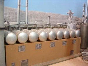

If you don't have a way to turn down the wood (no lathe), you could use PVC pipe end caps of the proper size and get a reasonable facsimile of a storage tank. If you wish to extend the length beyond that of two caps back to back, you will need to somehow fill in the gap. I would use thin styrene, roll some rivits into it, and wrap it around after joining the caps with a small section of pipe. This is two caps end to end.

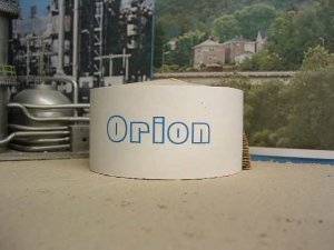

Mike, you could also use the cardboard spools crochet thread comes on. Of course you have to know someone that does crochet work to get them. They are 45 Nscale feet high and 43 feet in diameter. A bit smaller than what you said you would like. I cut them in half to make oil storage tanks for my oil refinery.

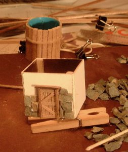

I have found and endless supply of tanks, useing the tops of spray cans which come in a variety of rounded and flat tops and diameters wrap them with masking tape it holds the paint better than the plastic....just a thought
jimmybeersa
May 14, 2001
508
92
Alberton . South Africa
Used a spray can top for my Water tank also wrapped it with masking tape to hold the glued wood sliding as seen in the back ground of this photo
