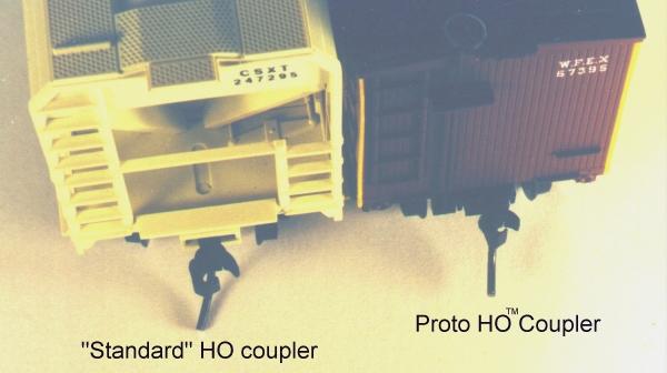

I use the Accumate Proto:HO's and I really like them. They look more like the prototype than the Kadee 58's which really look like nothing found in nature.
http://www.accurail.com/accurail/accumate.htm
They require drill and tapping but give a better looking coupler and couple better than the KD's.

The Accumate Proto:HO's. They look more like the prototype than the Kadee 58's which really look like nothing found in nature. They give a better looking coupler and couple better than the KD's. Absolutely, under the right circumstances. On a portable, modular layout, where every four feet is a disaster in waiting........,not always. Vertical changes in track, must be kept to a very definite minimum, and grade changes must have easements, especially where longer cars ( passenger, autoracks, 80+' flatcars, etc.) are used. The problems are more evident in longer trains.
There is no one coupler to use everywhere. The choice has to include appearance, sensitivity to grade/height change, lengths, and weights of trains. For the kinds of trains I run, in the environments I run in, Kadee #5 couplers work best. I do, however, have rolling stock that run with Kadee #58's, and can see the benefit of changing these to Accumate proto, for appearance. In these cases, I would clip the magnetic pins, because air hoses are already installed, and I usually iuse a manual uncoupling tool.
