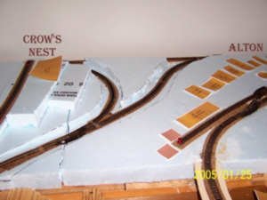

Cliff, you asked about foam and grades. Here is how I did it:
I temporarily laid the track on top of the foam and marked the location of the cut.
I cut the foam under the track right out. I was left with a "Y" shaped piece of foam that I could take outside for cutting. On the side of the foam I marked the incline I wanted. Note you will be discarding the bottom piece of foam so mark it correspondingly. Then with a large kitchen "Butcher" knife I cut the incline.
When I put the top of the foam back onto the layout, I still had the smooth surface up, so I could easily mount the cork and tracks. The rough cut surface was on the botom and easily glued to the bench.
A similar method was used for the incline to the left.
