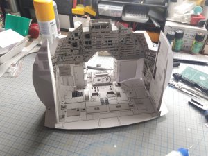

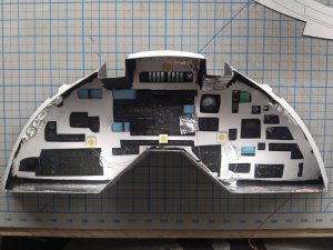

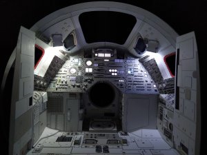

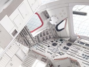

I tried several times to assemble in parts as Ken did, I did not like this installation. Assemble all panels and walls into one large piece.
While I put it on dry.

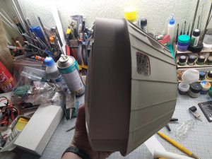

The outer side of the skin had to be painted, because bandings appeared during printing.

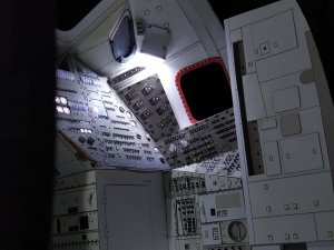

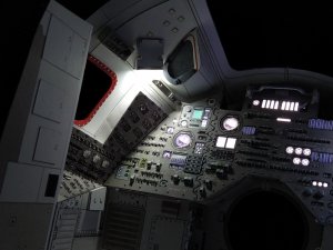

4 smd 5050 LEDs in the main panel are installed on the front and lits the rear internal wall, this gives a more uniform diffused light. The back wall is also painted in skin color, since the glow temperature of these LEDs is too cold, and gave off a blue tint. After changing the color of the back wall, the light became more warm and not so blue.

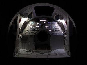

And of course, how could it be without a lighting test! Here you can see the temperature difference between the LEDs, they were from the same batch, and were in a row in the package, if it works out, I will replace it, if not, I will leave it like that. But this difference is not visible with the eyes, so I'll still think about whether it is worth changing one LED.

Wow this looks like the real model, no no no it's even better looking then the real model.
It's amazing what you are doing.

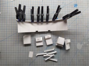

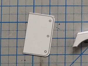

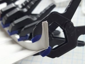

A small update, I decided to reinforce the arch with cardboard. The result is a 6-layer sandwich from 2 layers of paper, 2 layers of 0.5 cardboard and 2 layers of 1 mm cardboard. just the required thickness of the part is 3.5mm. Also assemble all the elements of this part.
Now I'm waiting for the glue to dry.
And I still do not understand where this part is installed.

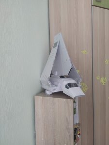

Well, I have no storage space for such a large model. And what was in the room of the youngest son, already take the shuttle Tydirium on a scale of 1:50.

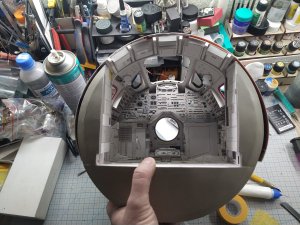

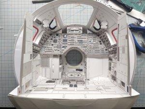

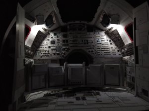

Slowly I continue to assemble, almost everything is ready to glue all the panels into the skin. I also took a chance and decided to replace the LED. Everything turned out without damaging the details.
Assembled hatch inner frame. The detail itself is very complex, so sorry guys I got carried away with assembling it and did not take a photo of the assembly process.
After LED Replacement
Before LED Replacement
