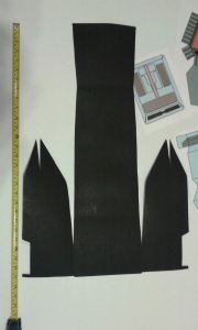

So, my first build thread.. Please bare with me. Have decided to do the Rubicon Runabout from Paragon. (Paragon is awesome) Everything I have done so far has been as close to 1:18 scale as I can get without getting ridiculously big. This appears to have overstepped that somewhat. Just now realizing how big this is going to get.20141118_171414.jpg
This may be a little ambitious. Any way, I am going to try and do interiors and lighting as well. I like to use black poster board to reinforce the card stock and also stop bleed through of the interior lighting.20141118_171515.jpg More to come soon.
