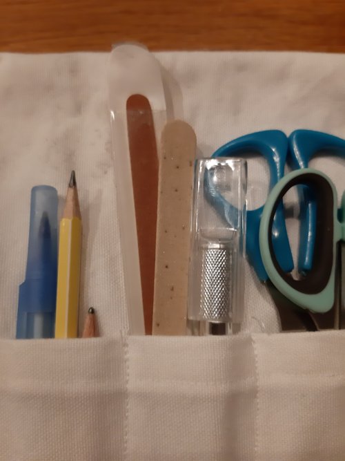

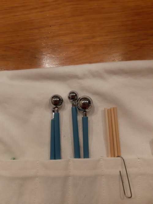

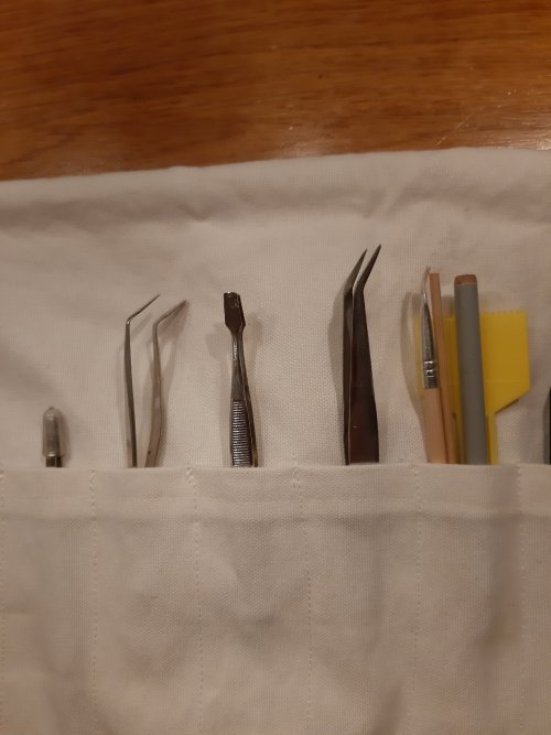

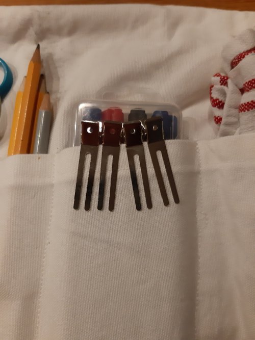

It depends on the model that you are making. I work a lot with spheres and rounded shapes so my tools are adjust to that. I will post a image of my setup.
