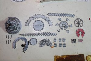

So... The promenade was attached and I cut the parts for the reactor plus a few strips for detailing on the promenade:-
This gave a central column which looks like this:-
The small cylinders around the circumference weren't long enough to reach the dots marked on the parts and I had to move them inwards a wee bit to make a connection. If I had to do it again I would remove the tabs on the cones to shorten the gap. It was a bit of a squeeze to get the column into it's final position so it's a lovely, tight fit. The result is:-

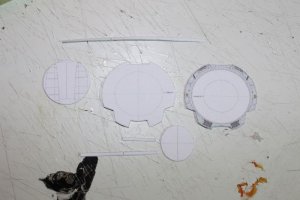

I've made a start on the three Akira class ships. The saucer is only 1" across so it wasn't worth the effort of adding names and registry numbers - they're unreadable at this size.
With the contouring parts attached, it was time to cut the pieces for the underside of the saucer and the deflector dish mount:-
I'll need to invent a new word for this - "fiddly" doesn't come close! I used very thin paper strips to connect the rear curves then curled everything round a toothpick. The housing for the deflector dish required something smaller so I used a darning needle to shape it. First I tried connecting one side of strips to the deflector panel - don't try this at home kids! ;) It was a stunning failure :facepalm:. Instead I found that connecting both ends of a single strip, working from the smallest to the largest, gives a much better result. Fortunately I'll be blowing the crap out of one of these so it doesn't matter too much if one turns out looking like a dog's dinner ;).

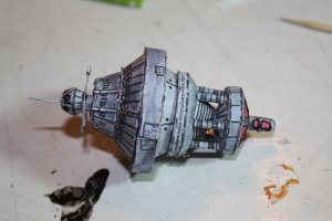

The undersides of all three ships fitted really well! I really expected one of them to be a total mess, but the gap was reduced when it was attached. The next stage was adding the contouring sections and bridge to the upper half of the hull:-
I used the blunted end of a toothpick to shape the lower section of the bridge, and the other, not so blunt, end for the miniscule upper piece. With these connected I cut the parts for the nacelle struts and weapons pod:-
