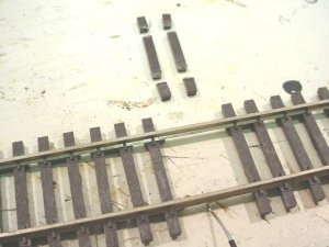

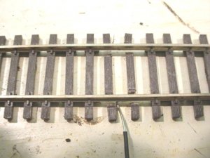

Now, on to installing the track. Take the ties we cut out and cut them into pieces as shown. Basically we are cutting out the portions which sit under the rails. Rail nippers work well for this.
Dry fit the track on the layout, and mark the holes for the wires on the benchwork. Drill a small hole down through. I used glue to hold my track down, so I spread the glue on the roadbed, then pushed the wires through the holes and pushed the track down in place.
After that is done, you can go back and glue in the cut ties so it all looks good.

Instead of actually cutting the ties out, you can cut out the little pieces of plastic between the ties and slide the ties over to leave an opening for soldering. Then when the solder is cool, you slide the ties back into place. Lots of ways to do this stuff.
I would be remiss to not add some safety precautions. Soldering creates heat which can burn fingers or set old oily rags on fire. Hot solder droplets falling on bare feet can hurt. Hobby knives are sharp and can cause bodily injury. Use proper care when dealing with dangerous instruments. Wash your hands thoroughly after handing products containing lead.
Ugh, that soldering iron tip looks pathetic in that one photo.
anyway, there ya go, take it for what it is worth, a haphazardly thrown together tutorial of a haphazard newbie soldering method and posted by dial-up at that.
