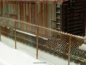

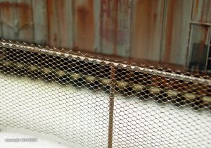

Scratch build chain link fence

I'm sure it's not a real fence cause I took the picture and built the fence, thanks!
cpNscale - the fence I made was HO scale and it's made from some material I found at Micael's arts & crafts store in the wedding area. It's called Tulle (sp).
Dave
Dave, looks very good.

My site is located at Rail Builder DHD's Weathered Rail Site and from there you can find the fence sample in the left menu but here are just a couple of photos. The web page has many more photos and detail of what I sed to create the fence.
Thanks for putting those pictures up... that is some fantastic work! :thumb: :thumb:
Did you use styrene rod for the posts and top rail? Did you weather the posts before adding the tulle or di it all in one shot? Lots of questions I know... ;)
That is some of the best looking fence I have seen. :D
Andrew
Thanks, it is nice to be able to save so much money on some details as this. Now I can spend the moeny on the other details like rail caps that will make this fence cost as much as the one from Walthers but have much more details.
rbDHD
