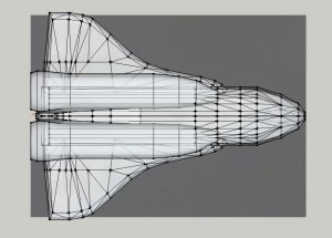

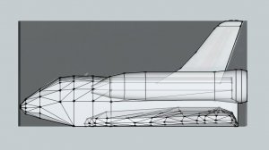

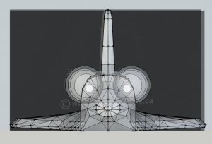

I have set up a first SketchUp model which will be refined. I already used very basic shapes to match the model's elegant curves and hope these will translate into paper well later-on. The goal is to create a sophisticated base model to make Ranger 3, the Searcher shuttle and the Pumpkin shuttle from BSG. And here is the first WIP picture:
You can see some deviations which need my attention because the images don't line up perfectly but so far I'm pretty pleased with it. Stay tuned! :)
I think you need to curve up just a bit to follow the curves that are shown in the picture under the front glass. It will make it look a little less blocky too. Otherwise, getting there. ;)
Which areas do you mean? There must be visible folding lines in certain positions. I have marked them in red. You'll have to deliberately crease these to replicate the look of the studio model.
Yup, that's the spot. If you made a template form, it could show people how much to curve the pieces, to give it that distinctive look. Picking hairs, but with someone of your talent, I know you take it with the good intent understood. ;)
