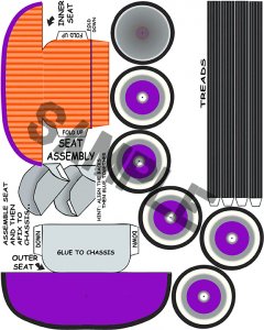

Image 06 I've moved on to page 02 of parts and recolored the green and purple as I did for page 01. On this page I wanted to use another Joker color and recolored the seat to "orange". This layer was set to "color". So we have now used three different layer fill modes, "darken", "normal", and "color". There are a lot of other settings that you can try. Each has a different use. This completes the "recolor" of pages 01 and 02.6-Finished Page 02 copy.jpg

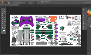

Here's an addition to the Joker's Clown Car. I opened the first recolor page and checked the size and it was 8 inches wide, so I went to "Image--Canvas Size", clicked the arrow on the left so that changes to the canvas size will go to the right, changed the width to 24 inches. That will give me the room on the right of the page one image to paste in pages 02 and 03. Click OK and the canvas size will change to 24 inches wide. Then I opened Page 02, "Select All", and "Copy". Click on the tab at the top for the canvas you resized and "paste". A Page 02 copy will appear in the window. Use the "Move" tool (the top right tool in the tool bar". You can click on the Page 02 image and drag it to the right into the center of your canvas or use the arrow key to move it. Repeat this process to add Page 03 of the recolored pages. You notice that you have 3 layers in the layer pallet. In the "layers pallet" you will notice a small arrow at the top right which is the Layers drop down menu. Click on it and scroll down to select "Flatten Image". This will make your image one layer. I saved the file as "AllSheetsForEnlargement" in JPEG format. My new page looks like this.
After measuring the model I found that it was too small to use with a 6 inch action figure of the Joker and Harley Quinn. I checked an action figure and the "thigh" measures close to 1 1/2 inches long. Next I will use a free "action" that I downloaded free from the internet. An action is like a Macro for a PC but it runs inside Photoshop. There are tons of them that you can download for free. They do everything from making your text into logo like illustrations that look like fire, ice, smoke, etc. or in this case will resize your images without loosing quality.

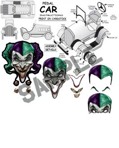

To use the "TLR Image Resizer.atn" in the previous post, download it to your desktop or where you would like to store it. Open Photoshop, go to the "actions pallet", click on the little arrow at the top right of the pallet for the dropdown menu, scroll down and select "load actions". Navigate the where you stored the download, click on it to select it, now click OK. It will load into your "actions pallet". Open the image you want to enlarge and select the section of this action you want to use. I selected the one called "Step Wise Upsize--width 110%--height 110%"(theres also one that will double the size of your image each time you click on it called 100% Upsize). This will increase the size of the image to 110% each time you click the play button at the bottom of the Actions Pallet. I clicked it several times and selected the "ruler" tool (third tool down on the right, hidden behind the eyedropper tool, click on the small triangle at the lower right of the eyedropper tool and hold down the mouse to show other tools, scroll down to the third tool and release to select it). For my use I was measuring the depth of the model's seat. I clicked at the bend of the seat, held down the mouse button and dragged down until it was at the front edge of the seat and released. Above the name of the file at the top of the screen just below the menu bar will be a readout that will give you the measurement distance in "width, "height", or it will measure an angle in degrees. After I got the image resized so that the seat was the size I wanted I saved a new image named "AllSheetsEnlargedFor6Inch" in JPEG format. Now that the model is resized I can make new 8 inch x 10 inch blank pages and then cut and paste the new parts to fit. I ended up with 6 new pages including the instructions and a 9 piece Joker Jester face in layer parts. I cut out what I didn't need so I could keep the page count down. I'll save the new pages into a new 6 page PDF and take it to my local printer on Monday.
(Changed the final pages to replace with "sample" watermarks added.)

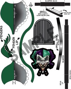

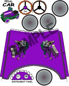

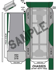

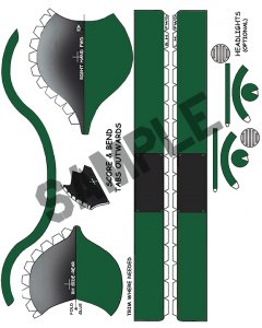

Page01Joker.jpg Page02Joker.jpg Page03Joker copy.jpg Page04Joker.jpg Page05Joker.jpg Page06Joker-Instructions.jpg

You did a GREAT JOB on the repaint of this model. I like that you also added addition detailed parts.
I am looking forward to seeing you build it!
Thanks Rhaven Black. I'm heading to the printer Monday morning. They are good quality with color laser and 6 pages will cost me like $3.00. I'm hoping that my Joker idea in layers for the grille will work.

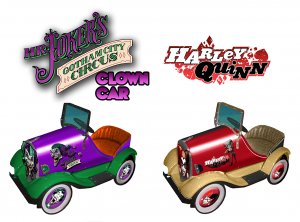

Hey Guys! And Gals! I was working on another repaint of the "clown car" this weekend. I found a few things I didn't like about the Joker car and made a few changes. Working with a "mutual friend" on redesigning it into a completely new and unique model. More news to come on that. I did have an idea for a Harley Quinn version of the car. Heres a Photoshop simulation of what they will look like when built. I'm getting my versions printed on Monday so I can start building them this week. Since they are both basically the same build I'll just create a build post on just the Joker car.Custom Clown Cars.jpg

Thanks Rhaven! I had different hubcaps on the Joker car but the Harley wheels looked so good I went back and changed the first car. The heads on the grilles will be layered and bent in a curve side to side to give it a more 3D look. I wonder now if I should have painted the windshield frame on the Joker car green to match the fenders.

These are so gorgeous. If they were edible, I'd eat them!! :)
Thanks Z!
If I do the Joker's Circus the Penguin and Ridder might be good too!
I got both of these printed on Monday and they look great. My Mom has been in the hospital so I haven't had any time to start building. She got out today and is back home at assisted living so maybe I'll get started this weekend on a build thread.
