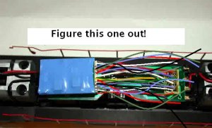

Deano....could you help me with THIS install?:gaptooth:
