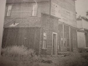

Picture # 1 This is my inspiration down lowded from the net.
Notice I made some lines tofigure out the roof dimentions.

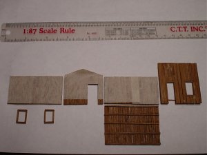

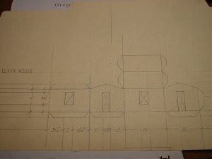

Picture # 2 This is a scale plan I made to visualise the size of the house.

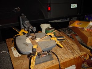

Picture # 3 My humbell shop ( The Mill )

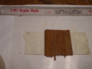

Picture # 4 I use masking tape to place all the boards toguether before building the interior frame.

Picture # 5 After the walls are put toguether I cut windows and doors, and add any interior frame as the floor underframe, and walls.
Picture # 6 As you can see one wall allready has the interior frame.

did that scroll saw work well for cutting the wood? Cutting your own is a lot cheaper.

I will post new picture as the project progreses, and to answer your question KIVEN yes the scroll saw works real god, my is a varible speed and for the real small parts I found you realy need it. What I do is on a 10" table saw cut board out a 2x6" srap cedar tha my friend save for me out of his work, the board I cut are 1/4x2" and then on the scroll saw I cut what I need for the model,one thing you need to remenber is to guide, and hold down the cut as you see in the picture.
