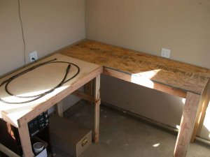

Since my MRC power pack didn't arrive Saturday, and I had extra lumber laying around the garage, I decided to re-arrange the garage a little bit and do this:
I flipped my layout around to enable the expansion from the 2 sidings. What do you all think?

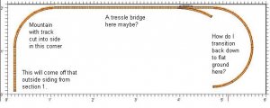

here's what I've come up with so far with that new addition.
You all are welcome to help me out with where to go from here...

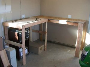

update
Here she is so far. I abandoned the 2 main line idea for the time being. I think it will be a very easy add on at a later date.
