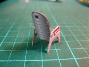

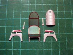

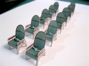

The model is built from the inside, and the first step is to assemble the seats.
First: print the parts. The arms and legs of the seats were slightly modified to make them look more like the ones used in “D” Tri-Motors.
Second: carefully score, cut, and fold. Don’t forget to color the edges. I use Prismacolor pincels for the edges.
Third: calmly and precisely glue the parts.
Fourth: repeat until you have enough seats for your Tri-Motor.
Fifth: thank God I am not building a 400-seat Boeing 747.

Very precise build. Detailing is terrific. Just look at the legroom! An added plus, no one hanging over into your square foot of seating area like on today's flying sardine tins. Nicely done!
Quite comfortable, for sure, but structurally, VERY Sardiney! :)
