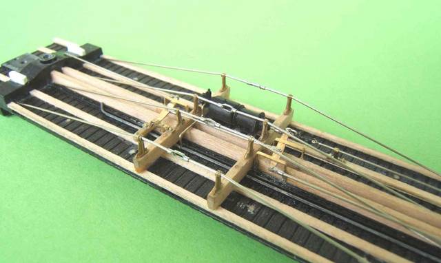

Here you see one of my models after replacing all under body parts where I used also truss rods which are built after the written way.
