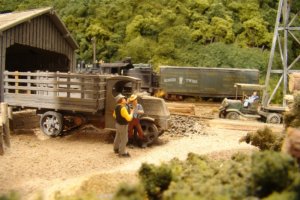

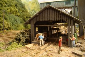

Hi ytter_man and co.,
Glad you liked the fording the stream scene. Apparently the branchlines in to the woods were so temporary that tracks were laid in shallow creeks without a thought of building a bridge. I am sorry I cannot locate the prototype picture from which this inspiration came from. I do remember Bob Boudreau (SP?) did a similiar scene in MR a few years ago.

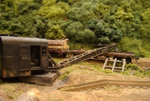

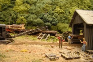

Travelling further East back out on the mailnline we reach the Kittom #1 lumber mill complex. Mr. Bubba is getting a stern lecture from the foreman after he dropped the boom of the Brownhoist crane he was operating into a flat car. The boom is bent and will be taken to the C&S carshops over in Railcamp for home made repairs. The foreman is making sure Mr Bubba feels his pain over said incident.
Doc Tom:wave:

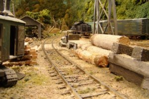

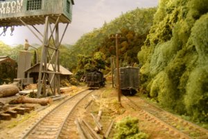

Well, lets go further east to the outskirts of Caseyville, Tennessee.Nestled in the mountains is the Kittom Mill #1 complex. There are several mills with many sawyers at work making sticks of wood from the trees that the lokies hauled to the site.
Notice the general clutter of the logging industry in the late 1920's. It has always been dirty dangerous work.

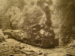

Hi Mountain Man,
Thanks for continuing this discussion about logging railroads in the mountains in the East and the Great American West.
I finally found the prototype pictures that got me going on modeling trains in rivers. It is in RAILS THROUGH DIXIE by John Krause (1965). The book had two interesting pictures of a Shay and a Climax fording streams on the Elk River RR in West Virginia. I love Krause's caption for the Climax in the creek. "In an episode so alien to dreadfully efficient Class I speed runs, Elk River Climax no.3 breasts a torrent while a nonchalant group finds nothing out of ordinary. They'd been here before and,besides, tomorrow might be worse."

Several years ago, I was out to Phoenix, Az. I had scheduled two stops on the return trip. A ride on the Grand Canyon Ry, from Williams, to the Canyon and back, and a ride on the Durango & Silverton.
On the trip up to the Canyon, the train came to a stop, in the middle of the desert, and we all had to de-train, and get on buses to complete the trip. There had been a heavy rain, in the night, and there was a washout that kept the train from proceeding.
The washout was repaired, and the train was in the station waiting for us, for the return trip to Williams, that evening.
This begs the question; "Why didn't they bridge the area where the washout occurred?"
The "logical" answer was that it was far less expensive to dump some new fill, and put in some new ties, occasionally, than it would be to build (and maintain) a bridge.
Besides, the idea of a train "fording a stream" has a certain appeal, and would be very much in keeping with "Don't spend any more on that line than absolutely necessary, it will be gone in a year anyway".
:mrgreen: Corporate greed is not a new thing! :mrgreen:
BTW Doctor G, nice pic's of "stream fording" :cool: :cool:

That must have given the engine crews moments of doubt! Thanks for the pics and the history. I never would have believed it if you hadn't. :thumb:

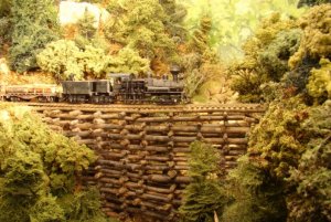

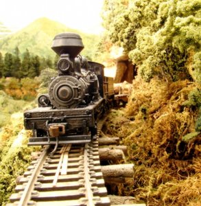

Log Crib Bridge too

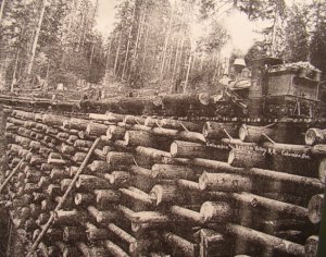

Hello fellow model rails and logging enthusiasts.
I have enjoyed the discussion the locomotives (real and model) in the creek has started.
Mountain Man is correct in that a large number of the bridges on a logging outfit were made from log cribbing. In fact some were pretty impressive.
I'm going to move the "picture tour" about 20 smiles East on the mainline of the C&S to show the large cribbed bridge built to cross a fairly formidable holler high in the Tennessee mountains. When the woods played out these precut logs could be taken apart, hauled to the sawmill, and turned into more lumber and sawdust.
I have included a prototype picture of the huge log crib bridge that inspired the model.
Doc Tom:wave:

I've got a cribwork trestle on my layout but nowhere near as impressive as your monster! That must've taken some time. What did you use for scenery in the lower right portion of the 2nd to last picture? Just WS stuff?
Keep em comin! :thumb:

Hi ytter_man,
Thanks for the nice compliments. The scenery material you are noting is el cheapo "floral moss" sold in big bags at WalMart and Home Depot for about $2.00. It makes a good ground cover before planting the trees.
The cribwork did take a while and is made from twigs taken from the woods arond here. I live in a log cabin (what else for a logging RR?) in a hardwood forest in rural middle Tennessee.
The cross logs are cut at a prototypical 16' to 18' length (I asked the local logger who fells trees in the woods around here.) and glued in place with clamps starting at track level and working down. THese are the same size as the cut sticks on the flat cars heading to the mill. When the woods played out the loggers would take down the bridge and haul it to the sawmill. Talk about recycling!!!
Doc Tom:wave:

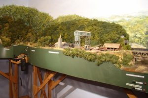

Reality picture
Nice work!! Man I love logging model railroads this is better than any I've seen in model railroading magazines! I wish I could have your layout. I love the shays and the logging scenes like the rails running through the creek bed and the cribbed bridge. Do you happen to have any photos that could give us birds eye views of your layout? Your pictures all have such depth that takes you away from reality but I want to see a few pictures showing a bit of reality like the walls of the room surrounding your immense layout. Also are there any projects on this layout or is it done and you're enjoying the fine thing in life of just running the railroad?
-Justin
Hi Justin,
I am posting a reality picture to keep us all grounded. This is a shot of the Kittom Mill #1 area of the layout. It's edge is only about 1.5 to 2.0 feet from the wall. It is the painted backdrop that probably fools the eye in the "up close " pictures that look like they have great depth.
The layout is built using conventional L girder construction and uses code 100 Atlas Flextrack.....very very basic.
The layout is almost finished wih one large scenic area , the Wonderland Hotel and Cottages, yet to be finished.
Thanks for your enthusiasm!!!!
Dr Tom:mrgreen:
