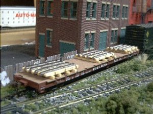

Here's another Walthers GSC flatcar; this one's being used as an idler car for an oversize load of hydro poles. The removeable pole load was made from tapered dowels, stained with an oil-based woodstain. The stakes are basswood, with thread used as "cable", to tie them together. The gondola is from Proto2000. All lettering is custom dry transfers, from C-D-S.

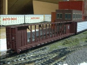

Ok....How about a centerbeam flat.
Walthers, Ready to Roll. Came from a two pack set. The one behind it has the Walthers "Wrapped Plywood" load.

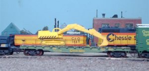

Here's an Athearn 40' flatcar that's been reworked as a boom car for a wreck hoist. The deck was removed and replaced with a scratchbuilt wooden one. The equipment boxes and tool house were built from styrene, with ladders from an Intermountain reefer, and metal steps and grabs. The Tichy derrick has been modified for service in the Southern Ontario snowbelt. Custom lettering on both cars is from C-D-S.

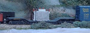

Here's one those Bachmann depressed center flats that comes with either a missle or a transformer. I added some weights inside the transformer,tied it down with black thread and added the C&O markings with some left over letters and numbers.

Thanks, Josh, the loads were based on recollections of watching real ones being erected at the steel plant where I used to work. The paint is Floquil Reefer Orange, a pretty close match to the prototype.

Fantastic loads DoctorWayne:thumb: :thumb: :thumb: They look like the real deal.

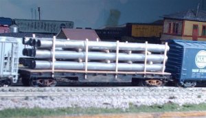

Here's a flat thats been modified and a load added. There's no prototype I know of for this. The pipie load is another home made project using straws,match sticks,and tooth picks.

Nice load, chessie4155, and an imaginative choice of materials. Actually, I'm surprised by the number of neat flatcars and interesting loads that have appeared in this thread. Nice work by one and all.

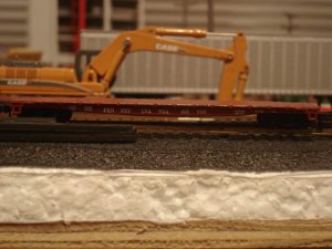

Here's another MoW flatcar, an Athearn fifty-footer. I built a new wooden deck and some low sides, then put it to work as a boom tender for my American derrick, which, it appears, was elsewhere when this photo was taken.
Here's a photo of the two together, snapped by the ever-intrepid (and foolhardy) Barney Secord. His low-flying antics are viewed with more appreciation in some rural locales, but this stunt earned him a stern reprimand. The derrick is from Walthers, and that Pennsy gondola, loaded with track bumpers, is a modified Concor product.
