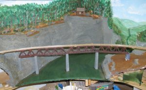

Bill Nelson
Dec 14, 2008
2,678
465
Clarksville Tn
I am testing the western river crossing over crooked creek. I got over my diversion to Harlow's retaining wall , and got around to carving and painting these cliffs, once the bridge is all the way in, I can extend the eastern mainline another 18 feet down the eastern wall of the RR room. I'll have a humongous passing siding , and a long siding there, which I can use as a staging area, until I build the lowest level of the central peninsual, which will have the iron furnaces, and a massive logging camp on it. Smaug likes the new cliffs!
z Smaug  likes  the  new  clifs!!.jpg s

Bill Nelson
Dec 14, 2008
2,678
465
Clarksville Tn
with Smaug's approval of the cliffs, I have been applying acrylic gloss medium to the river, and starting to paint the backdrop. I broke the rules and started with the foreground. I should have started with the sky and clouds, and distant mountains. I did not, and there will be hell to pay, but I like my woods anyway. I'll put foreground trees salvaged from my old mountain in front of the back drop, and have an awesome primordial forrest. I did the tree shapes with three different shades of acrylic green, and a piece of sea sponge. I'll have to come in and add some variation to the colors of the tree trunks, as well as painting some logs, limbs and other organic trash on the ground on the backdrop to match the stuff I'll litter the forest floor. the river is a little lighter color in real life. folks who think that color is just wrong, well white Oak Creek, which we pass on the way to Kentucky lake is often a shade of green that is totally inexplicable.

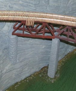

Bill Nelson
Dec 14, 2008
2,678
465
Clarksville Tn
On friday I roughed in a pier for the Western end of the bride out of styrofoam, and carefully trimmed it to match the angle of the cliff. I also carved a block of foam to make a foundation for the Tannery near the east side of the bridge. This weekend while at the lake, I carved stone work into them. I test fit them a little ago, and they fit just right, so It;s time to paint them, and install them.
I need a coaling trestle at the Tannery, and at the lake I remembered I have the old wide bridge deck that crossed the log pond at the club, leading to the Patterson #1. I'm going to trim it so it extends only a few ties past the foundation to the smoke stack, cut a hole between the ties , to lead to coal bins under the bridge deck, and I'm going to loosten the spikes, remove the code 100 rail, and slide some cone 83 rail in there so it will match the rail in the area.
soon the river is going to be at the point I can start installing trees along the top of the cliff.

I painted the foam bridge pier, and put the first protective coat of polyurathane varnish on the river. the gloss acrylic medium looks beter, but has a fragile surface . when the varnish on the river dries, I can start installing foreground trees along the cliff, and making the primordial forest floor back to this corner. that is going to make this area my most most scenic spot, until I get to my upper deck. I have also shortened the bridge deck stolen from the club, and removed the code 100 rail (leaving the spikes in place, so it should be super easy to get the new code 83 rail installed); I need to cut out some holes between the ties to dump coal for the tannery. I should be able to start extending the track onto the Sander's switch block soon. za bridge peir detail.jpgZa rivercrossing  close!!.jpg
