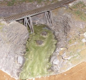

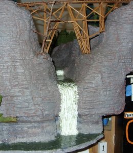

enclosed are photo's showing the sander's Gorge waterfall, and Tom's bend that just got it's maintenance dose of acrylic gloss medium
