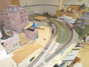

aaa_harlow_main__ac.jpg aaa_harlow_main__ab.jpg aaa_harlow_main__aa.jpg I have the main line in through Harlow, the inside track is a very long passing siding the outside track will lead to a future riverboat warf.
The snow scene is my front yarf this morning.
tracks along the river that will lead to a warf for the riverboat and barges. very nice getting the basic scenery done before track installation keeps things neat.

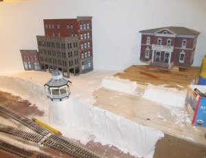

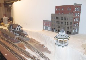

aaaa_new___taller_buildings__for__harlow.jpg I got my train oerder and have started work toward building kits for the new Harlow, got a slow start , as I had a busy beginning od the ewwk, and then got ill. this will be a big change, old Harlow had no buildings except the Imperial Desk and Chair Co. that were more than two stories tall

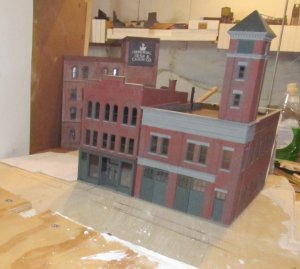

aaaa_harlow_firestation___courthouse__square_3a.jpg aaaaharlow_firestation__3.jpg Having fun with buildings, am working on a fire station with a hose drying tower for the right of the Court house square the fire hose drying tower will allow me to hide another piece of all thread to support the upper deck. I am studying the court house roof, trying to design a tower for it.

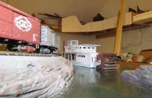

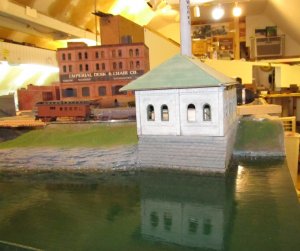

aaaa_rounded_corner_of_river_2.jpg aaaa_rounded_corner_of_river_1.jpg doing some more work on the river, found the water based polyurathane floor finish I was hoping to use. used a belt sander to even up the outside edges of the river and round the corners. I also have a support put in for the base of Main Street, which will also support the buildings on Main down by the corner with Water street.

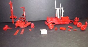

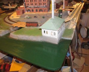

aaaaa_fire_truck_parts_a.jpg aaaaa_riverbank_a1.jpg aaaaa_riverbank_a2a.jpg [/ATTACH] getting there with the river! have also been working getting the last bit of backdrop on the center spine ready to paint with the Sherman Williams Brisk day that the room is painted with, and I also use as a starting point for any backdrops. I have also been buiding some Jordan Miniature fire trucks. I have the sub assembalies ready to paint before final assembaly. the details on these things are mind nubing, imagine brake petals on an Ho scale T model. then imagine trying to get them glued in right.

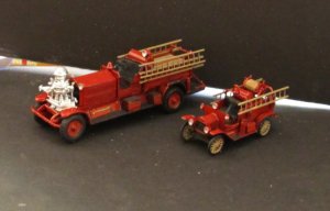

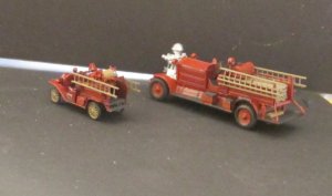

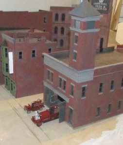

aaaa_fire_trucks____firehouse.jpg aaaa_fire_trucks_a.jpg aaaa_fire_trucks_b.jpg I got those fire trucks almost done, I need to get a paint that makes a good representation of brass, I had some I had used on train bells and whistles, but it was 15 years old or more and dried out. in the mean time, I put the trucks on the layout by the fire station. I may want to re locate the all thread support rod, so I can move the firehouse farther from the street to have more room to display the fire trucks in front of the fire station. don't know why, but one of my images is doubled the upladed images only show three, but I get one of them doubled, sometimes I can fix this with editting.
These Jordan Miniatures fire trucks are amazing, especially since these kits have been available for over 30 years Yje T model wheels have valve stems, and these trucks have brake petals, that is an insane level of detail for HO

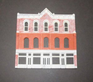

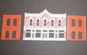

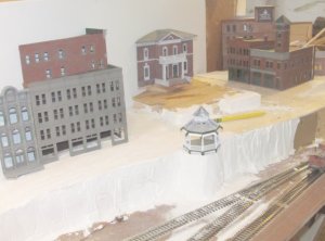

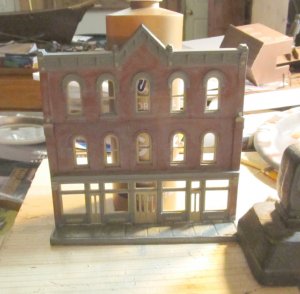

a_kitbash_3_sstory_4.jpg a_kitbash_3_sstory_3.jpg a_flat_kitbash_3_13a.jpg a_flat_kitbash_3_13h.jpg farthrer down main street, I had a flat made from a DPM kit. I really liked this building, but that street needs taller buildings. I realized DPM modular sections with arched windows had windows simaillarly sized and spaced, so I cut up several of them and used them to turn this two story building into a three story building. the side walk is made from dese foam from hobbly lobby, cut up mat trays will work just as well but take a little more work cutting up. I have all the sub road bed in for the switching leads on the back side of harlow. once the roadbed and track are down there I can play with building locations over there as well. It will be time to get the Harlow block wired up and working soon. it will be easy except for the two crossings. I wnat to set them up linked tot wo switches, so that when the switches are thrown for the DG CC & W RR main, the crossings are wired for the DG CC & W RR, and when they are thrown for the Southern, the southern's side of the crossings are powered. That will be complicated to wire, but If I can pull it off operations will be easier.

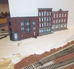

a_lower_main_1a.jpg I got it in place on Lower Main, and it looks OK! I have to get the sidewalk squared away for the building on the corner, and build stepps for where the siewalk elevations change. in old Harlow, the change in elevation of the street, and the way the building height, and sidewals were stagered; was one of my favorate parts of the scene. reproducing that in the new Harlow is very satisfying

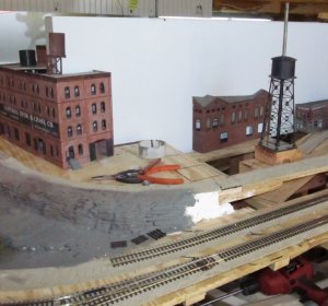

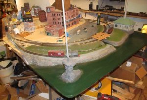

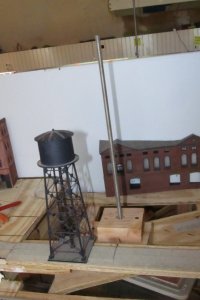

a_all_thread___water_tower_a_1c.jpg a_all_thread___water_tower_a_1a.jpg I moved the all thread through the fire house an inch and a half toward the river, so there would be room in front of the fire station to park the fire trucks oustside the station, wher I can see them. with the all thrad located on the front side of harlow, I was able to set up another piece of all thread just opposite it on the back side of Harlow. I hid this one in a water tower. below the tank it is painted black to represent the water pipe, above the tower it will be painted sky blue (Sherman Williams Brisk Day, to match the backdrop, and the walls of the RR room

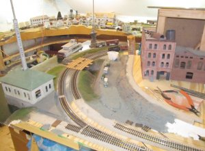

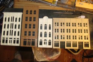

a_fun_with_flats_2a.jpg a_fun_with_flatsa1.jpg I have been playing with some of the flats that are refugees from the old main street. I have been fitting them to a curve in the backdrop near the helix. thse will but up against the walther's merchant row 4 (?) buildings. thsed fronts will need some short wall sections and roof sections, glazing and other details

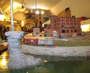

a_imperial_desk__and__chair_27a.jpg a_imperial_desk__and__chair_27b.jpg I have the track in up to the Imperial Desk and Chair Co. In Old Harlow, that sidding was off the Southern wain line that was just for looks, soon when I wire Harlow, I will be able to Switch the imperial Desk and Chair Co. for the first time! Have also experimented with the location of the smoke stacks for the electric utility. Need to cut some lumber for a massive coal trestle fot the electric utility and the coal dealer, that trestle will run from just behind the watertank to the near corner of the electric utility. the river is starting to reflect but is not as shiny as I would like yet.
