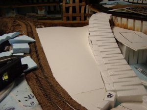

So the first thing I did was add gatorboard to make the section more level and usable:
I stopped the board short of the river so I would have room for the slope and the stairs down to the water.

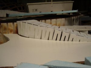

I borrowed steps from one of the buildings to illustrate what I'm trying to do:

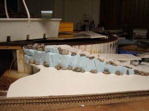

I also turned my attention to the retaining wall problem on the side of the road:
I decided to take
Russ' suggestion and model blasted rock (or as close as I can come to it
This was begun by cutting a thin strip of blue foam and carving it into flat irregular rock faces and then adding real rocks to help blend it all in:
It will need Sculptamold and paint later. I do plan on having plenty of wood retaining walls scattered about town to add variety:thumb:
