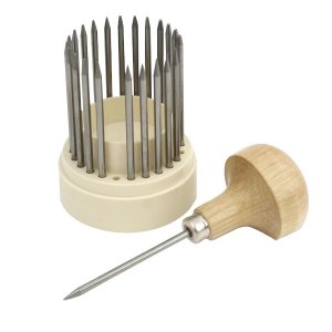

I do not know how big are your holes, but I use this set for punching small holes (0,25mm - 1,35mm)
Reactions: cecilmeyer

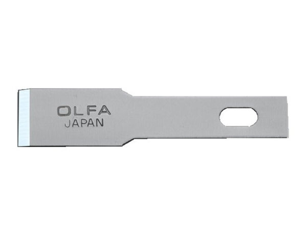

You can use this type of blade and shorten it to be about 2 mil wide.
Then you can "punch" four sides of each square quite fast. I saw it done this way (much more then 400 squares) and the guy did it realy precise. It looked like laser cut.

I tried using a small flat head screw driver. It works but it takes a lot of effort to make sure they are straight!
