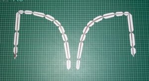

Before printing I slightly changed the layout and the flap positions of the parts. I also deleted the unneeded texture images which reduced the file size to one third of the original one. I was a bit afraid of the thin strips but these fears were unjustified. Here are the first pics of the build:

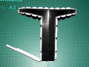

The visor parts were printed on glossy photo paper. Unfortunately the surface proved to be very fragile and when I glued the piece to the frame I noticed that my finger nails had left it with a lot of bad scratches. For that reason I'll prepare a revised part which also will remove the edge in the middle.

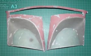

Today's progress:

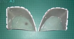

The left ear piece was assembled.
However, the test-fit showed a minor intersection with the main body of the helmet.
Since I had added several flaps to the ear piece it was easy to glue it in place without having to cut into the main body.
The bottom piece was adjusted accordingly; the triangular shape was simply glued behind the ear piece.
The back piece was assembled...
... and attached.

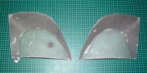

Well then, work continues with the right ear piece and the additional joint.
This is the part as it was designed.
I noticed that it would be better to cut off the inner flaps.

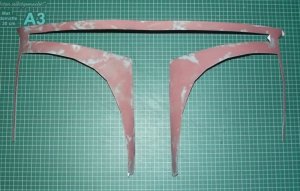

The ear piece was attached to the main frame. Then I began building up the rest of the helmet. I did not use the flaps of the parts. Instead I glued some pieces of scrap paper to the back of each row, made several cuts into them, bent them inwards and glued the next row to them. This produced a very clean result:
