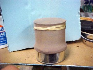

I use this dirt as is for ground cover, but for ballasting, & other situations where I need a really fine dirt, I sift it again, this time through a nylon stocking stretched over a metal can...

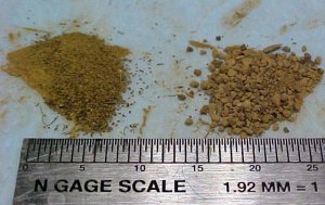

What I'm left with are 2 grades of dirt...
The dirt on the right has gone through the window screen, & the dirt on the left has been sifted again, through the nylon stocking...
