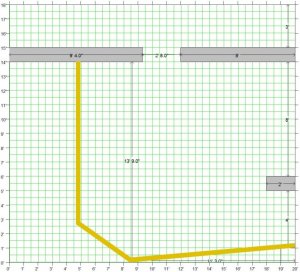

Here is a CAD drawn of the blank room. The 1' thick GREY walls are cynderblock and the yellow walls will be wood stud walls.

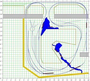

Below is the first level. The main yard/town area is on the left side of the layout. I will operate this as a point to point RR, but I have put reversing loops on both upper and lower deck. Although I won't be able to run trains from one end to the other because of a switchback section half way around the plan.
The center peninsula is going to be a sawmill kit from SeirraWest. "Twin Mills at Deer Creek"[/URL]
The feel I'm going for is similar to layout this guy built. Degulbeef & Cradding Railroad[/URL] I really like the terrain and the coloration he capture.
Here is the upper level. It starts in the upper right corner at 20" above the lower deck and wraps around clockwise up to 24" on the upper left corner. This deck will be the higher logging and mining camps up the mountains.
If anyone has any suggestion on the track plan, PLEASE speak up. I am very flexible to make any improvements to better the operation. And again if you want the CAD file I can send it to you.
