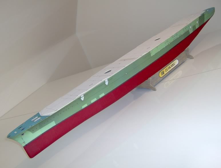

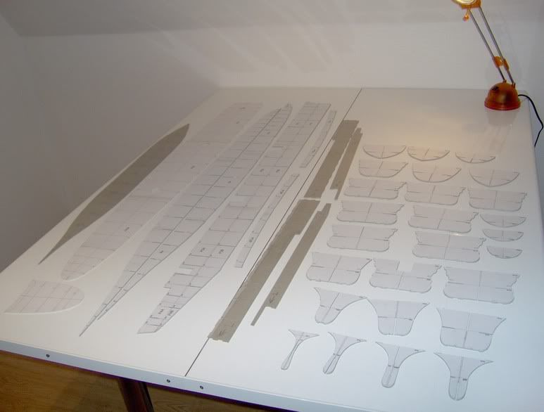

The hull is effect of an experiment. I tryed to build one without colapsing hullplates. Spaces between the frames are filed with car putty supported by cardstock strips. Maybe those photos will be helpful.
Flat surfaces of the hull were covered with added cardstock plates.
Sanded hull was covered with paper. There is no paints.
I'm no more using this method. Now I'm building next aircraft carrier USS Saratoga CV-3, and the hull is wholly card/paper one.
It gives very good results.

jnyoun
Apr 19, 2007
119
Highlander,
Thanks for the pictures that show how you make that excellent hull.
After I look at the pictures, my jaw just dropped and it was hard to bring up again. :twisted:
In your picture, it seems that you made your own 'cover part' for each 'between frames'. Is this correct?
I'd like to know more details how you make your own 'accurate cover part' and how you attach them as in picture.
Thanks
JN

It's difficult for me to explain in few words how to make with this method (one of many) a good hull. I thing the best sollution is new thread. I'll show step by step how I'm building new hull. It'll be soon and I hope You'll find in it something interesting.
jnyoun, I'm using 'transparent paper' :twisted: Detailed instruction comming soon, please, be patient.
