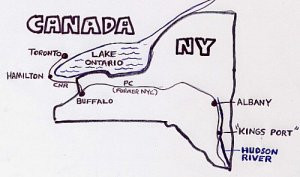

That's great Val! I'm wondering about the border crossing though...did you locate it near Detroit because I'm in St. Paul? I've placed Kings Port and my layout in Upstate NY as its a vague (very vague) model of Kingston, NY along the Hudson River.
Checking some maps in my books about the Penn Central I propose this route from Toronto. I'm not sure of the major yard near buffalo but I imagine at least the cars to and from our businesses might get sorted at the large yard in Selkirk near Albany.
Now we just need to designate a time shift point where our trains shift from 1950s to 1970s! :)

Hi Ralph. Yes I thought it would come from St. Paul. That's no problem though, Buffalo is also a major transfer point for x-border traffic. I'm thinking it would probably be NYC in the 1950s going through Albany, Buffalo and Hamilton. No doubt in Hamilton, more steel would be added to the train from Stelco, the big steel plant there.
It's kind of funny, but even in my fantasy world I am feeling guilty about not "Buying Canadian". But then, I got such a good deal from Kingsport Steel, what's a Robber Baronness to do? :)
