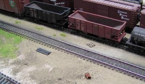

Thanks Will. Robin, I wish I could tell you more about the wheelstops, but I bought them quite a long time ago and removed them from their package, so I don't remember who makes them. A guess would be Cal Scale, or Miniatures by Eric. I do know Credit Valley carries them, so if you want some, I'd start there.

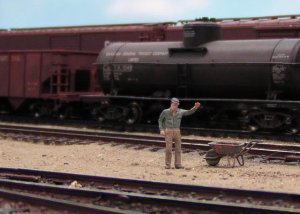

Val: Glad to see you have a man with a wheelbarrow cleaning up the litter. This is Toronto, you know!
Robin: the wheelstops may be by that place near Kemptville (can't remember the name, and mine are out of the package).

Robin: re: Wheel stops. I think they're by Juneco. I had a brief hobby shop stop in St Catherines today but didn't see any.
