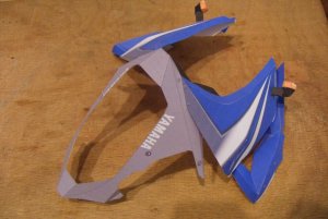

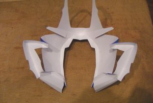

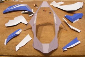

Front Cowl
I found the instructions giving too little information as to how the part A1 look like that's why I added some photos from different angles.
I'm not finished with this part as it needs some filler on those gaps and some painting there.

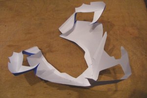

Hmmm...

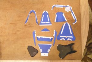

Here are the parts for this step BUT...
c7/c8 came out twisted:cry:. Time for some "plastic surgery":
Decided not to build Frame1 yet. I will build the engine and then the frame around it.
Frame 2
Attention is needed when gluing so that it's not twisted.

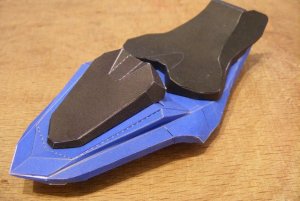

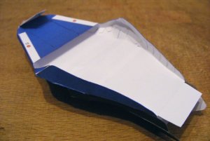

Fuel Tank
Not a problem here, just glue the 2 parts starting from the back side

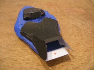

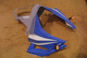

Under Cowl
Had the same problem with the frame. It helps if you used lighter paper for the frame. That way you'll be able to manipulate the shape around the engine if the frame doesn't come out right.
I thought I was careless when I scored, bended and glued the tabs:eek:ops:.Oh, well...
On to the next:
