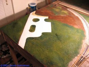

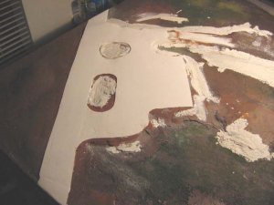

heres how the left side is starting to look like. I took some spackle and started to make the road and area where the gas station will be. The Pavement area is pretty much done in the way of the spackle i just need to build the gas station get the ground painted and lay down the "asphalt" & "concrete" I actually enjoyed doing the roads.

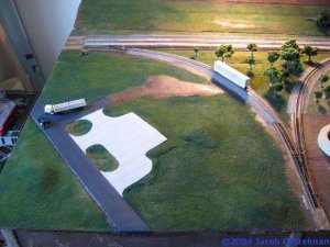

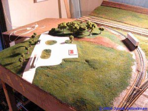

Well since we had problems with the forum I'll post the picture I had up last week. I'll also add a couple others.

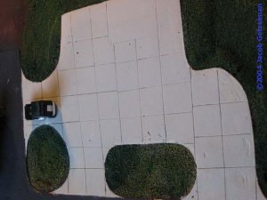

That second one i had to compress so much it looks like crap now :curse: originally a 2272xwhatever.... well heres the lot area. I've since painted it with concrete. I should take some pictures of that :p these squares are about 12'x12' I put the truck there to give you an idea. I'm thinking i made the squares too small as i've noticed concrete can be in bigger areas. Oh well this will be fudged :D Anyone know anything about how the concrete would normaly be spaced? I've found limited information on this subject.

Sir_Prize
Mar 5, 2001
826
51
Port Charlotte,Florida
Have you tried looking at Pics of Airport Runways (Of course these days that could get you in trouble). Anyways, looking at images may be your only way to figure the spacing. You might try a search for Building warehouses, or hangers (they often have wide floors).
Sorry... Only suggestions. I don't have any straight to it links.
MasonJar
It's not rocket surgery
Oct 31, 2002
5,363
Ottawa, Canada
Part of the 401 in Toronto is still concrete slab construction. The slabs are about 12 feet wide (one lane), but are longer - I don't know by how much. It is hard to judge distances when travelling at 100+ km/h. Maybe 30 - 40 feet long? I think your squares look just right for a gas/service station.

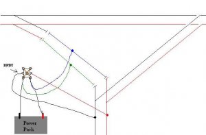

SD90- as for the radius on the curve they are both a little under 24" mainly because of the space i had to squeeze it in. I tried to get it as close to 24 as possible because of the N-trak standards. If they reject using it i wont be too upset. The main reason i made an N-trak wye is to connect it to my future oNe track modules. I was also informed i have to use an auto reverser if I use dcc to reverse the loco as far as polarity and direction. Apparently you cant manually reverse it with dcc beause you have to have something smart enough to reverse the direction of the loco in the isolated section.

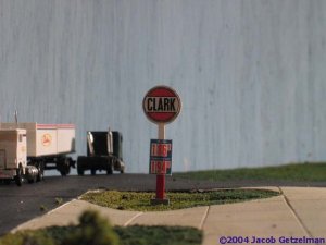

After break from modeling aka deployment to Georgia.... I started working on the gas station some more. Partly since all monday I was stuck on the Apartment without a vehicle. My truck just stopped running in the middle of the road so I coasted into the Whataburger and called some friends from work to see if we could figure it out. After some scratching of the heads, I called for a tow truck and had it taken to the dealership since I got the extended warranty. Well enough of my rambling....
Here's the road sign with the gas prices. The prices are adjusted to reflect the current year as shown.

b28_82: the reversing module is your insurance. It also is something you can put in and then forget about.
If your wye was just for reversing locos, I would suggest hooking it up through the dpdt switches on a switch machine. But if you have a string of modules beyond, it would have to flip their polarity every time you changed the switch.

Yeah the plan is to have some way of attaching my future oNe track modules to an Ntrak setup. I thought that I could do it manually the way i was planning on wiring it as shown below
