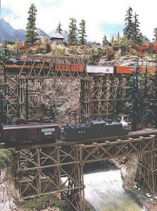

These two trestle bridges on my layout were made using the method shown in my article on trestle bridges. Doesn't matter what size you want, the principal is the same.
Shamus

i've been seeing your instructions shamus, but something came up...
what size should i use to buiild a trestle on N scale?
i want to add one, because i will add a some interesting scenery to my layout... and i want some challanges.... :)

Okay, but how about....
Shamus, once again you're helping me out. It took me a few times but I read through your instructions and think I have a pretty close, but not complete understanding of what to do there.
I guess it can't be made with matches, which was the original purpose of the post.
All kidding aside, at the point it says, "Now here’s why you didn’t knock those track pins all the way home", I get lost. Not knowing some of the terms used, it's a bit hard to follow. Soooooo....
What are the odds you could make a single, simple riser for us all, taking pictures at each step, so we can REALLY see how you work your magic? Just a thought

Luis,
That depends on what space you have available for a trestle bridge. I made one in N-scale that was 4' long and 12" tall spanning a river bed, so the sky is the limit my friend.
Shamus

i want to build one 40 cm long and 3 cms high. but can it be double track?
somewhre there will be a river!!! yeap!!! i want to have great scenery layout!!!!
msh, you had a great idea... let's make shmus post some pics showind how is done... hehehehe
