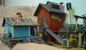

Hi
I prefer on locomotives brass and other metals (because of weight).
On cars (did not build many) I use laminated paper or cardstock and styren.
On buildings recently I prefer wood and with metal, stone and plastic accessories (like windows).

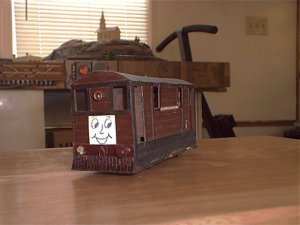

This is an O gauge Toby the tram engine I built from cereal boxes years ago for my son. It has a drive built with a VCR motor and belt drive. He has seen better days.

Can you give any dimensions on the "Toby" body.
I have a 2-yr old grandson just coming into wooden "Thomas"
now and his 6-yr old big sister has a collection of most of the Ertl metal Thomas stuff.

Hi dan,
Most of the dimentions were taken from an Ertl Toby and scaled up to aproximately O scale.
Its 6 3/8" long, 2 5/16" wide and 2 7/8" tall at the sides. The highth at the center of the roof is 3 1/4 ".
It wouldn't be hard to power one with an old Lionel locomotive drive.
I also built Duck the Great western engine, but he didn't survive. It was geared a little to high and suffered to many high speed derailments.
