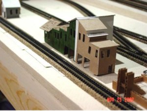

Do you generally build your windows for your structures or do you use commercial windows?
The Shamus structure below in particular is my current project and I just wondered what the experts do.

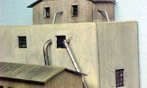

I ran into this problem when I was building a flour mill for my N scale layout.
I dug around through the house & came up with a great little trick for representing N scale windows...

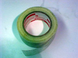

It's plastic mesh tape used for dry-wall joints.
I just cut some pieces to fit, painted them, & then glued them to the inside of the structure with CA.
I then glued some clear styrene to them to represent the "glass".

That's a great suggestion Charlie about the dry wall mesh. I know you have posted the idea before but it is timely to do it again as it is a very good one. Most times I just use MS paint to draw windows and print them out and past them on.

Thanks for the comment on the structure. Actually that was a trial run to see if I "really " wanted to do S&B stuff. Shamus posted a plan for another gauger and I copied it on cardboard, cut it out, glued it together, and painted it. I liked it so much I did another piece to see what I could do for a packing plant industry. That is what you see. So now I am going to build that structure in wood and needed the window question taken care of.
I had never thought of the mesh tape. I have a roll of that in the basement. Excellent idea. The "Gauge" comes through again!!!:) :) :)
