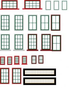

Hi John,
I very often make my own windows using the computer and printer. The windows are printed onto clear plastic sheeting available where you buy your printer/paper from.
Shamus

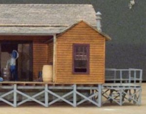

John,
Like the others, I will use Grandt Line windows (HO scale), of leftover windows from other projects. The window in the picture, however, is a working double hung window, scratch built with Northeast Scale lumber, and clear acetate glazing(HO scale).
Pete
