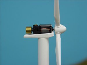

RAY METIVIER
Jul 14, 2002
53
85
OHIO
home.woh.rr.com
WIND GENERATOR, RPM
MIKE
Im sure you are correct as to the rpm.
As you will see, no room for gears, already had to make the housing 3/16" higher to fit the motor.
Im not saying I will give up, but until I find a better way, I'll have to live with what I have

G'Day Ray.
Great idea and great modelling.
Don't know if you have tried it, but have you investigated non model railway motors?
Say from a firm that specializes in small motors.
There are plenty of applications in the electronics world.
Are the posts hollow?
If so, it might be possible, if the diameter is large enough, to have a belt drive from a geared motor below the bench.

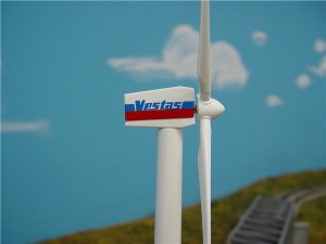

Personally, after looking at the photos you posted, if you have these things running smoothly at 30 rpm, with as good as they look, I'd be ecstatic to be in your position. Those things are GREAT! I was eyeing the model airplane props at the hobby store today with the idea of maybe sticking a couple of these up on top of the mountain on my layout...;)

alex_mrrkb
First, welcome to the gauge.
Now, I guess you want me to give up my secrets. Well the wind generators are a Walthers kit, a HO kit at that. I used my N scale rule to measure the hight of the tower, and length of the blades. Actually the measurments are smaller then the wind generators used today. So, so much for scratch building. The motor housing had to be made 3/16'' higher to accomidate the motor, which is a Atlas loco motor. I found that I could not run them slow enough to suite me. I now am working with LL (Like Life) motors and they run at .7 volts dc and 25-30 rpm.
