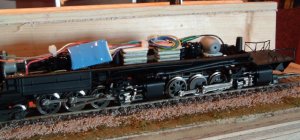

Welcome to the Gauge...I'm waiting with bated breath at the opportunity to snag one of those malleys at the club. Having already seen the mechanism for one of those Y6bs, my fix will work just fine. First you build a cradle from scrap wood and a towel. Then you set up a peice of track on a flat and level piece of plywood.

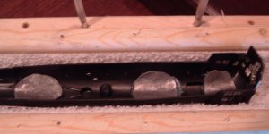

Chessie, this part's for you. When I bought the Cab-forward, it had an unusual tippy toed gait to it. The rear engine would ride the rails only on the very front driver. All others would rise up in the air with no chance of touching the ground. This was caused by the boiler weight having warped and pulling everything (and I mean everything) out of line. By carefully breaking the weight into three peices and carefully gluing them back in line with JB Weld, I was able to salvage it. After it hardened, I filed and shaped it, then painted it black to keep it from further corrosion. Then it was simply a matter of tweeking and filing 'til all 22 tootsies touched the ground.

Three 1/2 oz. fishing weights were then hammered flat, shaped to fit inside the boiler, then placed---one over each gear tower, one in the cab roof. They were then attached with silicone adhesive caulk.

The drive train has some pretty loose tolerances so that the loco can negotiate 18" radius curves. This not being necessary for me, I tightened them up, making sure they were as straight in line as possible. Then I stretched the plastic drive shaft by cutting it, then using heat shrink tubing to lengthen it, making it flexible but having more grip on the gear towers.

Opposite the drive train, I added weights to the frame, an ounce and a half balanced just ahead of the rear set of drivers. That was it. It crawls at the #5 setting on my Digitrax throttle and pulls quite well for a 35 year old.
