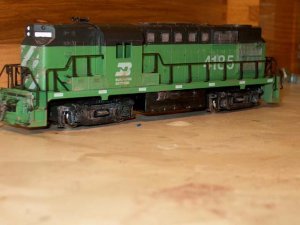

Loco LED lighting
I was putting a decoder into an old Kato that has the one bulb in the center. I was thinking that if I could glue a couple of white LEDs into the carbody and then run wires down to the decoder....
Any thoughts on this idea?
Drew

Re: Tips & Tricks
Originally posted by kf4jqd
Drew:
What kind of ideas are you looking for?
Andy
Well Andy, I'm just not sure about things like glueing the LED's into the shell. What type of glue? Then I'd need a couple of inches of wire on each lead to reach down to the resistor and decoder. I'm just not sure that I could shove all that loose wire safely under the hood!! I have an Athearn SW1200 that I want to do as well, and there is even less room under it! I just don't want to get the lights nicely installed, and then I can't get the carbody back on!!! :mad: :mad: :confused:

Ideas
Hi Drew, Right now I don't have any particular ideas in mind on installing the LEDS.....Haven't owned a diesel loco in years....Steam Rules!!!:D
Doesn't seem that installing the LEDS in your switcher would be a hard job. Just need some real flexible wire so you can keep the wiring out of the way of everything. I use 30ga "flexwire" for lights and sound in my locos but its real hard to find.:(
While thinking about this I went over to one of my junk boxes and found an old flat cable that was used to connect the controller card to the motherboard of a computer. I cut the connectors off and pulled the individual wires apart and BINGO!!...nice 18" pieces of real small flexiable wire!!!:) :) Sometimes I amaze myself!!!:D :D :D
