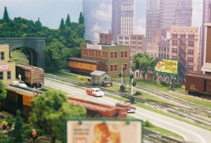

Josh, i outlined both sides of the road with 2'' tape, keep in mind i do layouts the old fashioned way, with a wood top, NOT FOAM. so i am not sure what tape would do to foam. then i took a spreader and laid out an 8th inch thick road, at the rails i taped off the top of the rails and the area between the rails. after i laid the compound on i pulled the tape up before the compound dried, that made the edges nice. one problem using that stuff is "pot holes" that might show up. if the holes are small, i just left them, if they needed to be filled, i had to wait for the compound to dry, then go over it again. or you could try and sand them out. then you have to paint it. in the end, it will look GREAT, but to me, its alot of work that could have been spent doing something else;) tooth1 . below is a pic of the road i used the compound to do, not a great pic of it though.:D -Deano View attachment 28758

Josh!! if it sticks well to foam, you might NOT want to use it, remember,announce1 you HAVE TO TAKE THE TAPE OFF!!, i think there must be a better way for foam. you guys with foam:rolleyes: , i think i will stick to the old way...with wood, makes life ALOT easier.;) :D -Deano
