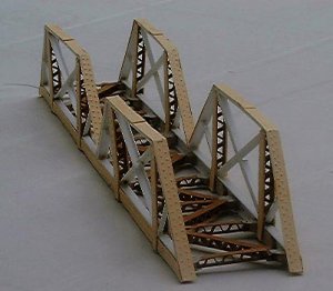

Our colder weather has arrived enabing me to get back into my loft after one very very HOT summer So here is this weeks production A corrigated cardboard bridge ...a.la Robin My first post in quite a while, Glad to be back

Is that EVER cool! Well done, sir! :thumb: :thumb: :thumb:
I also would love to see that on your layout.

Hello Jimmy - it's fine to hear from you again! :wave:
And I see, you didn't lose your talents in the hot Summer. :D The filigree bracing of the beams looks great! And yes - how did you do the rivets?
BTW - is this H0 or N scale?

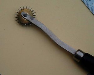

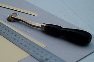

The Rivets? I have some thin card... a throw away from our local printer, My wife donated
( after some gentle words and endearments) a wheel with a lot of spikes,I think it is for spacing stiches when doing hand sewing, I place a steel rule along the strip of card and make a line of holes turn it over and you have a line of make believe rivets, the white glue fills the holes made by the points of the wheel. will photgraph the wheel tomorrow and post it. Alternatively find a sprocket from and old clock or something that has gears that suits the spacing you want mount it on a handle after sharping the teeth to make indents on the card. works well on foil or copper sheet as well

Hi JImmy, the bridge looks great and its good to hear from you again. The wheel you speak of, or one like it, is called a ponce wheel. I have a set I got from MicroMark. This for the info of those who don't care to go to a sewing store!

The Rivets? My wife donated ( after some gentle words and endearments) a wheel with a lot of spikes,I think it is for spacing stiches when doing hand sewing,
Don't ask me how I know, but those wheels are used to transfer a pattern to material using carbon paper. You run the wheel along the pattern "cut" lines and it puts little dots on the material to follow when cutting.
