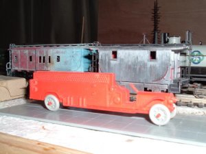

I posted pix of this work way back when but, with this new camera, I thought folks could get more from better pictires.
The Model Power Firehouse comes with what has got to be the ugliest vehicle of any sort on the market. They call it a firetruck and it may indeed be one but only in the academic sense...

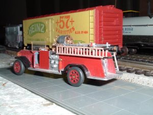

Add "Sparky" the dalmation, a bell and fire extinguishers made from sprue material and locomotive gladhands...

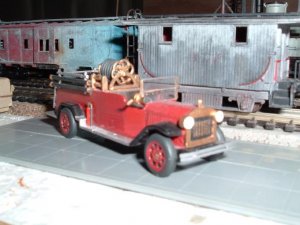

So much for the tanker, now on to the pumper. The hose reel is two brake wheels and thin solder for a hose, the valves ar N scale brakewheels and sprue material...

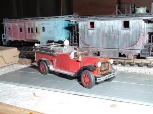

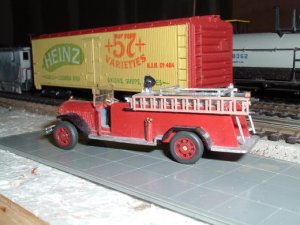

The crank siren is an old model ship fog horn and more sprue bits.
The strap bumpers on both of them were the hardest things to do being made from very thin Evergreen Styrene strips. The windshields are scribed clear styrene with the brass frames painted on.

Thanks, guys. They were inspired by a scenery article written by Bob Hayden and Dave Frary. In it they were using the wheels as junk in their scenery. Knowing where the wheels came from and having two of the kit trucks sitting in my scrap box, I figured there's got to be some kind of more noble use for them. There is about 5 hours in each one, plus another hour of painting. The biggest modification is the rear on each one. You can see in the pictures where I cut out the top and back of the body as well as cut out 3 1/2 scale feet in the middle to shorten them up to a more realistic length. I added body panels around the cabs, making them appear to have an open door. I also cut off the axles and replaced them with styrene rod to help them sit a little lower on the road.
