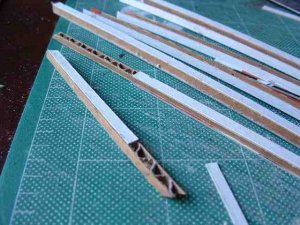

Just thought I would show you here how I make wood beams.
Just cut strips of corrugated cardboard. These are 1/8th inch . Next I cut strips of cerealboard and glue them on both open sides.

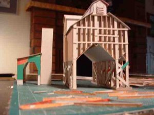

Here I am adding wood beams to the coaling tower. Lots more to go but this is where I am at today Sunday the 27th. Did quite a bit while watching NASCAR Winston cup race

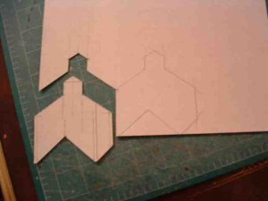

Steel trusses ready to install. These are designed to support the weight of the coal. The gussets are paper. Next step before installing, is to paint them rusty black.

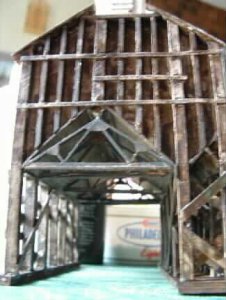

Some of the steel trusses in place. I have stained part of the coal tower with a dark walnut stain to make it look like the original tower had been coated with creasote.
