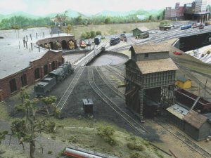

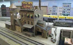

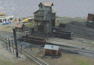

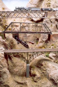

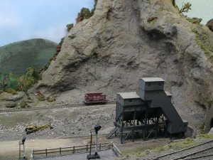

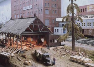

Loren, I posted a reply with pictures a half dozen times and they don't show up. What gives???
....Ott
Ott Gangl
Mar 21, 2008
10
I am learning, only six pictures, oh well.
....Ott

Hi....Welcome to the Gauge...!!! Are you trying to attach the pictures directly to the post.., or do they "reside" in one of the picture-hosting sites..?? There's two different ways to go about doing this. Check out the "Sticky" thread at the top of the "Photography, Books, Video, Scenery" sub-forum. N Gauger gives a very thorough explanation of how to do this.
Good luck..!! & let's see those pics...
Ooopppss...looks like you were posting as I was writing this post...Looks good..!!

Ott:wav: , I'm sorry about the hard time you had posting pics:winki: , the problem was your a new member, and the system this forum runs on thought your pics were spam:eeki: . The system is set up this way to keep spammers away, it does this automatically until you get a few posts under your belt:winki: .
AGAIN, sorry for the inconvenience:smilie: , BTW, AWESOME PICS!:thumb::mrgreen:
