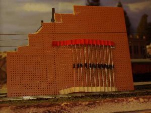

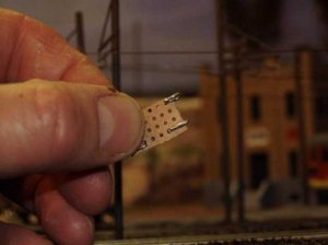

This is the assenbled light direction controll. Make sure the white band is away from the bulb lead, then it will let power through when in that direction mode and stop power going through when in reverse mode. The other diode will do the opposite.

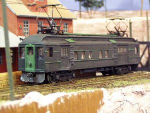

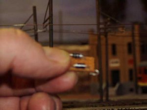

and a pic of the back side;)
Wiring.
As you know you have two pickups on the motor we use one side for all avalible pick up off all wheels.
The other side picks up power from the pantograph
Lights.
Two leads off each bulb.
one of each takes power from the pantograph.
the other leads must pass through the diode`s and then to the wheel pick up on the side of the motor.

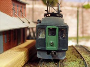

Now I have to try my hand at weathering and then she will be given her roster #:D :D :D
Hope you can understand it all.
I will show you Glenns after he gets his hand fixed up.
Cheers. and happy scratch building.

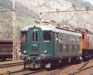

Chris, this was (and is) a very interesting thread with your step-by-step explanations. And the result is well worth the effort - a traction combine with a distinct 'face'. Great modeling! :) :) :)
The funny thing is that this 'face' with a front door looked very familiar to me. :rolleyes: And then I found the Swiss 'sister' of your combine:
Here in Switzerland in the late '40s the first hi-speed electrics, two truck passenger locos were built. The first series also had a door in the front side, complete with a bellows behind it. The idea was to join it with the passenger cars, so that the conductor could ride in the loco after checking the tickets of the passengers. (Already in the second series this front door was omitted.)
Now doesn't she look a bit like your combine, although she's 'only' a locomotive? ;)
Ron

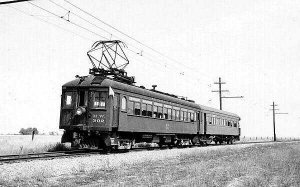

The doors on the heavy Traction also allowed the operators to pass from one to the other when they ran as a two or three set.
Also The Traction roads of old often converted coaches to motorised equipment. It was a far cheaper way of refurbishing.
Now that gives Chris:D :D :D :D A licence to mix and match when I build;)

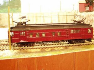

Here is an old pic..
Sacramento Northern. with the similar front.;)
Have you a shot of the red unit behind Ron????She looks intresting to my eye:p

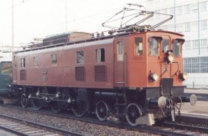

gladly I send you a pic of the second engine, an 'Electro-Pacific' so to speak! She was built in the '30s.
Her type designation Ae 3/6 II: A = Top speed 110 km/h (68 mph), e = electric, 3/6 = 3 of 6 axles powered, II = second series. Since she ran on a pass line here in my vicinity, she's got the nickname 'The Trimbach Cab-over-wheel lokey' :D :D :D
(There were two more series, Ae 3/6 I and III, but with different power arrangements for the driving wheels. This one is by far the most attractive of the three. She is run now and then as a 'museum machine' by the Swiss Federal Railways SBB.)
If you look closely you see the other one I posted before coupled behind her. Of course both photographs were taken at the same day when they pulled an electro-oldtimer excursion train.
BTW, the green one is a Re 4/4 I: R (Rapid) = Top speed 125 km/h (78 mph), e = electric, 4/4 = four axles, all powered, and I = first series.
Hope you enjoy this loco, too. She is one of my favorites - I just love engines with driving rods!

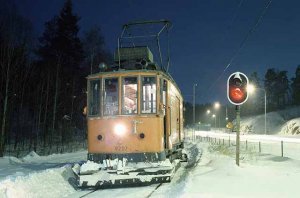

This thread reminds me of my local traction road
They are from the 30ies and had an effect of 260 kW and could run in 60-70km/h :)
Here is an X3p 35 and an X4p 37 :)
