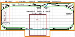

SAL Comet
May 13, 2004
409
N.W. Georgia
Ha Brakie, I'm afraid you lost me at the end of your post, wouldn't they both be "center stage" layouts?
Screwysquirrel, Thanks for the tip, I see your point. Here's one with the run around you suggested. Also included a removable section connecting the yards, which are now double ended. I lost some staging, but continuous run was one of me original goals. Better?

Urban
Oct 30, 2003
20
Sweden
www.canit.se
If the connection over the bed isn't too much in the way, this really is a good solution since now both staging yards can be used as a single yard giving lots more flexibility.
Jun 30, 2003
678
53
Raleigh, NC
Looks great!
just one other, optional suggestion:
Somewhere near your 'Racoon Creek Trestle' I would add a turnout heading toward the back, a track reaching up toward the wall and a crossing, and call this (very short) track the interchange with the Southern. It never would need more than a car or two, but would make things look a lot busier without adding any more room.
here's a small pic of what I have in mind, the orange is your SAL mainline, the green is the Southern crossover. You could change it to a simple crossover instead of the turnouts if you didn't want an actual interchange:

Russ Bellinis
Feb 14, 2003
4,501
76
Lakewood, Ca.
I'm not sure how high your layout is going to be built in relation to the height of the bed, but presumably the layout will not be in use while the bed is and vice versa. You could make the connection over the bed either removable, or a double "draw bridge" so it would be out of the way except when operating the trains. Don't forget to leave room around the bed to make it without interference from the layout.
SAL Comet
May 13, 2004
409
N.W. Georgia
Ha Screwysquirrel, That's a great idea, I've been trying to figure a way to keep the Southern on the layout. What do you guys think about this one?
