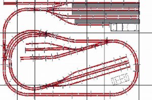

Ok was unable to sleep last night so redone my track plan opened up a little Russ tride what you said but got meself well confused lol

Russ Bellinis
Feb 14, 2003
4,501
76
Lakewood, Ca.
Ok, I hope I can help unconfuse you. You have a double track lead coming from the mainline "oval" into a 90 degree turn into the station complex. Right at the edge of the second square leading into the yard throat, you have what appears to be a cross over track going from the outside to the inside tracks. Then just past the yard throat you have a second crossover going from the inside track to the outside. Those 2 crossovers combined will allow you a run around track, but it appears that using those two crossovers only allows you to run around 1 or at most 2 cars. My suggestion is to make the first crossover parallel to the second one. If the trains are short enough to allow the engine to escape without fouling the crossover where the lead leaves the mainline, you could eliminate the second crossover entirely that is just beyond the yard throat. Now you pull your train into the station and unhook just at the crossover in front of the yard throat. Pull your engine(s) forward through the crossover, and back down toward the main and through the second crossover that is right off the main. Then you just come up to the back of the train and push it into the correct station track.

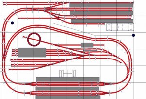

Ok at long last the finale track plan track here and ready to go nw baseboads arrived last wenesday few bits of track lrft to buy then job done I start

Why me

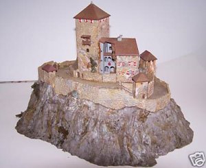

The othe pics are my kibri castle that needs to find somwhere to live on layout and barden barden station plus bonn station being built
