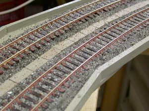

Pic 1: I take a not too small brush (No. 1-3) and load it with paint which is a diluted somewhat (about 2/3 paint and 1/3 thinner). Then I slop the paint on rather carelessly, not trying to be very exact. Here you see a stretch of PECO flex track mounted on cork strips. The paint covers the rail sides, but also the track nails and a bit of the ties. What I try to do is to leave the center of the ties free. This gives automatically the impression of spilled oil and soot along the track center.

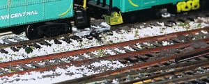

Pic 2: Next step is ballasting the track. I use bird sand, a sort of granite sand which I got dirt cheap (a 2 kilogram bag about $1.50) in a local pet store. I fix it with the usal mix of 'wetted water' (i.e. water with a few drops of dishwasher rinsing agent added, or a water/alcohol-mix) and white glue (water:glue about 3:1). But then I'm also adding a shot of black india ink to the water which helps to tone down the clean ballast.

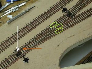

Pic 3 shows a short piece of double track with additional weeds in the ditch between the two tracks.

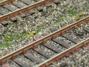

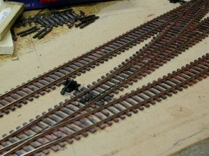

As an addition: A few remarks about rust-painting turnouts:
Try NOT to get paint between the switch points and the stock rails (--> WHITE arrow). This is e.g. quite important for PECO electro-frog turnouts. On the other hand, the inner sides of the switch points SHOULD be rust colored and not glossy (--> 'RUSTY' arrow).
And finally you should also paint the upper surface of the guard rails and the wing rails near the frog (--> GREEN rings) a rusty color. In reality, the parts of the rails which make actually contact with the train wheel are the only shiny rail sections in a turnout.
