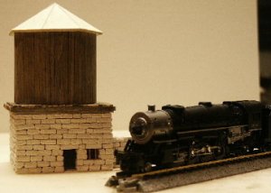

with #3 I'm wondering if this will be high enough once the spout is attached?

Neat water tank!
to post several images you need to place them on another web site, then use the IMG button to add the url (web address) where you want it withing the post.

Well the tedious aspect has paid-off big time as the realism is fantastic. The cold joint between each stone combined with the shadows makes the effect very believable.
Originally posted by belg
The blocks are made from plaster first I poured an 1/8" thick layer and then scored and snapped 1/4" strips then cut and fit like bricks. A very tedious process.

That is supurb work, especially the stone walls.
I'm thinking that something like that would look great on a layout with no roof, doors or windows. There are lots of abandon buildings like that around here where all the wood is gone and only the walls just like yours are still standing.

If it is too high or too low, you can always redo the landscape onto whic this fits...set in on a slight hill, or into a light slump...Eitherway, beautiful.

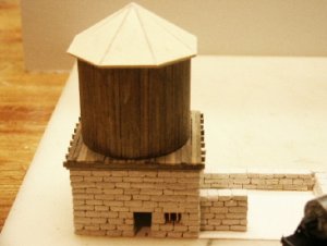

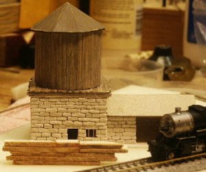

Here's a new photo of the watertower. I put together a sample of some scraps to get the color for the stonework as I do not want to go onto the real thing til I'm happy with the color, which at this point I'm not. There is not enough variation in the tones and I'm thinking a grey contrast would be better. Any opinions?
