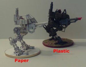

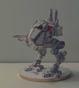

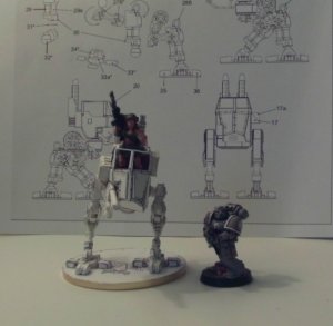

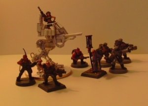

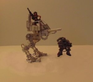

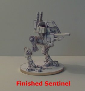

As mentioned in Flarebaffle's thread, I will start a Warhammer section with some of those fabulous models uploaded by Armorman. Eli Patoroch has done a remarkable job in the designing and constructing of those armor vehicles. My first attempt is the Sentinel and by no means will it end there. This Sentinel is about the correct size of the original and it is very well detailed. There where some modifications done like in the foot pads but over all, the model went together rather well. Here are a few pictures of the model and soon I will start a build thread with the color version.
I have placed some of the Warhammer Imperial troops next to the model so you can compare the size and also a Plastic Sentinel so you can compare and see how close to the size and detail is the paper model.

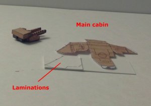

the start

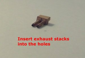

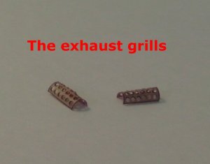

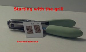

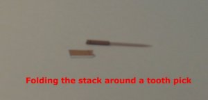

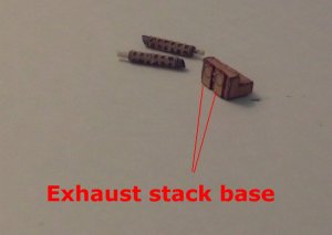

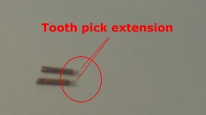

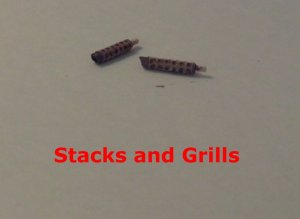

To start this session, I begin with the Exhaust module. With a small punch, I made the ventilating holes for the exhaust stack.
Next I took the exhaust stack and wrapped it around a round toothpick. After the stack is set, I placed and glued the toothpick half way in. There is a little of the toothpick sticking out of the bottom. This is done different from the plans, in that it will be inserted into the Engine block and it will be more sturdy. The backs and edges are colored in.
There are about twenty pics for the the exhaust section. There are more sequences to come.:wave::wave::wave:

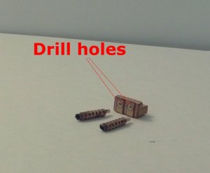

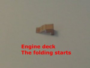

Continuing with the build. Used part #9 and started to fold the parts. Parts #9a, the stack base are laminated and then placed in to their locations after coloring the edges.
Once the plates are set. Drill a hole big enough for the toothpicks extensions in the stacks to go in.:wave::wave::wave:

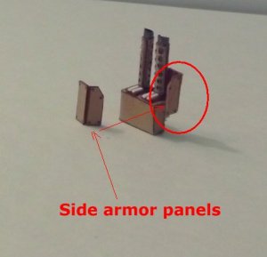

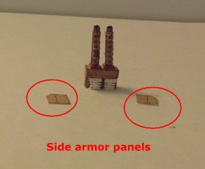

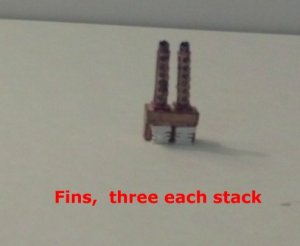

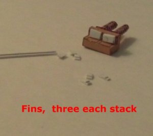

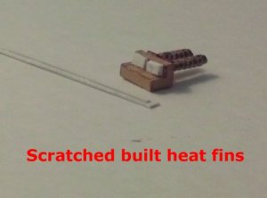

More on the exhaust stack. The pictures are a little out of line but you can see that I made some modifications with the heat fins. Those side armor panels will come in the next installment. The white sections are the scratched built parts, But you can use the ones in the kit as well. The small strips are on the original plastic model but you can do without them as well.
The fins were done by gluing a smaller strip on top of another slightly wide strip. Measure the width of the fins and glue three stacks as shown. It will give the illusion of the fins.:wave::wave::wave:

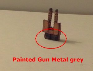

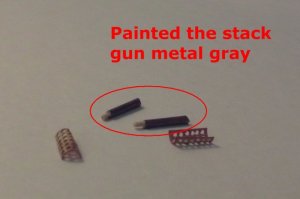

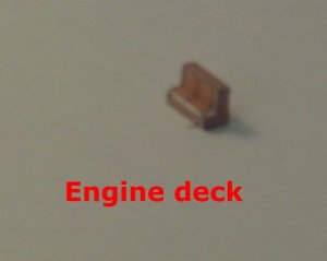

Almost finished with the exhaust section. For some reason the pics are out of order again. The main cabin should be at the bottom. You can see the lamination of the side panels. They are thick enough for edge gluing and does away with the tabs.
As for the engine portion, I painted the fins a gun metal and colored the white side of the armor plate a darker brownish color. The side armor engine plates are also glued to a heavy cardstock for thickness. More to come and see you next installment.:wave::wave::wave:

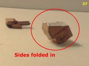

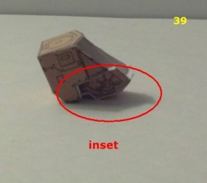

Some more work on the cabin. I guess the size of the pictures in pixels, determines the positioning of the photos. To make it more flowing, follow the numbers on the top right corner of the photos for the correct sequence.

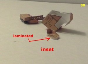

36. The sides are laminated and only kept the front tabs in place. Folded them into position.
37. The sides are in place.
38. The indented part is folded with the top portion laminated.
39. The indented part is place into position

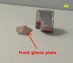

40. The front Glacis plate is ready for placement.
More to come, See you all next round.:wave::wave::wave:

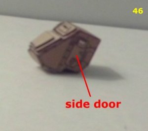

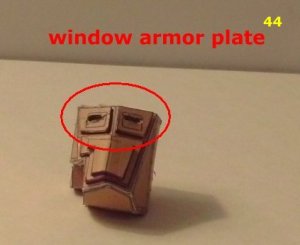

Sentinel.
More on the cabin.

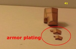

41. The front armor plates, laminated.

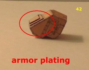

42. Side view of armor placements

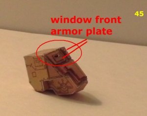

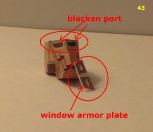

43. Blackened the cabin area where the view slits are to be. Trimmed out the view slits on the view port armor. This is also laminated.
44. Armor view port are in place.
45. Side view of view ports
46. Side door added. Not laminated.
So much for now, more to come, enjoy. See you next posting.:wave::wave::wave:

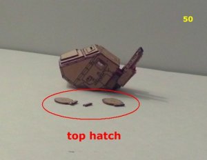

Sentinel.

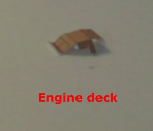

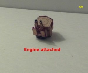

On with the show and more stuff.

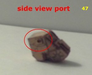

47. Placed the side view port, laminated 1ply.
48. Attached the engine module on line bottom edge of the lower back of the cabin.
49. Rear view of the engine module.

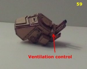

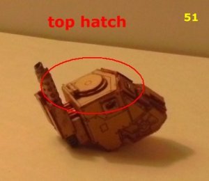

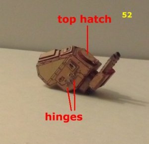

50. The top hatch is made up of three pieces
51. Stack the hatch pieces as shown. All the pieces are laminated.
52. Attached the hinges straight from the sheet, non laminated.
Still more to come. Enjoy and see you all around the next posting.:wave::wave::wave:

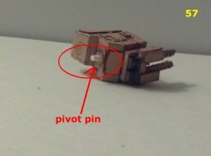

Sentinel.

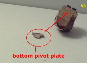

in continuum, more on the cabin. How about that.... This post came in out in sequential order.

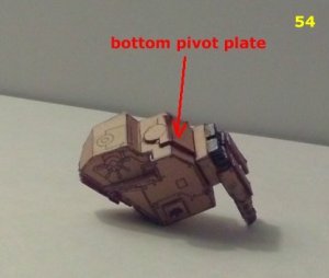

53. Bottom Pivot plate laminated bent into position and glued on.
54. In place, you can see the lamination.

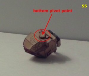

55. Laminated the round pivot point and placed on plate.

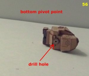

56. Drilled a hole for the shaft. I am not using the one in the kit. I will be using a paper stick. (Paper Q-Tip)
57. Paper stick from a Loli-pop, Q-tip.

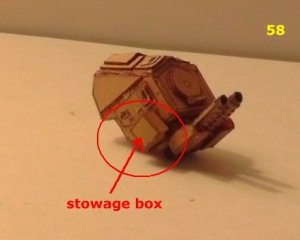

58. Starting on the outside cabin boxes.
A few more details for the cabin, it is almost done at this stage before I go to the Legs and the base.:wave::wave::wave:

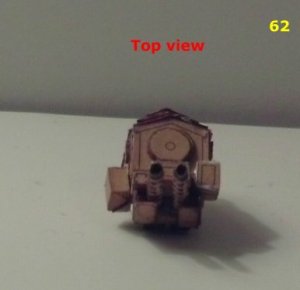

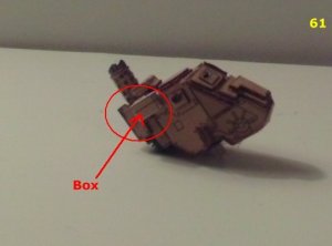

Continuing with cabin.

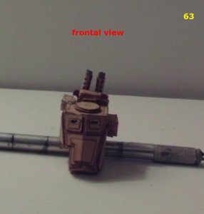

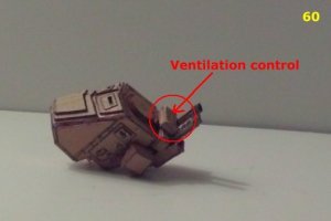

59-60-61 Placement of the external boxes and things.
62-63 Views of cabin.

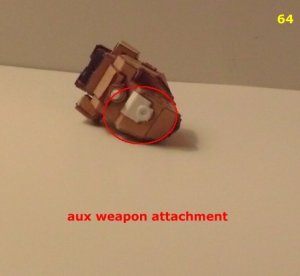

64. Scratched built front weapons auxiliary attachment point.
See you all next posting.:wave::wave::wave:

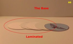

Sentinel.

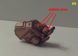

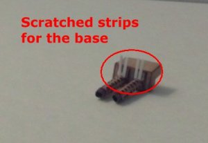

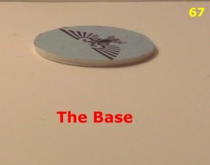

More details.
65. More external boxes

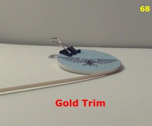

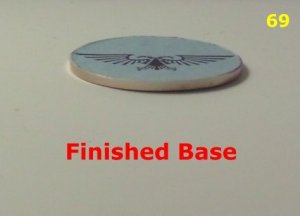

66. 67. 68, 69 The making of the base. Place it to the side and have it ready when the model is finished.:wave::wave::wave:

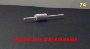

Sentinel.
Getting there. The devil is in the details.

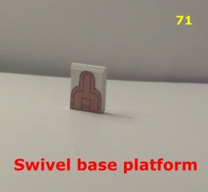

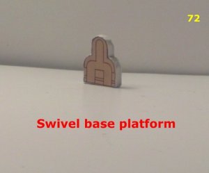

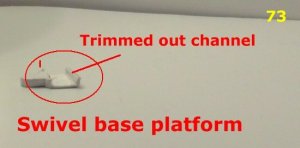

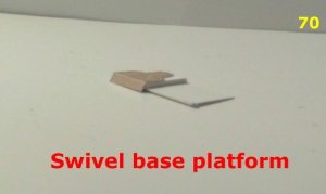

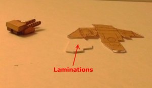

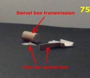

70. 71. The swivel base platform. I laminated the whole section by mistake. Should have laminated the front section and left the channel open for the Gear box.
72. The edges are rounded off.
73. Here is the channel carved out. Should have left this area open.
74. The gear, transmission box made by rolling the paper strip around a shaft. In this case a paper stick but a micro screw driver would work better.
75. Placed the trim around the swivel base and the pivot point panel on the base.
Stay tune for more.:wave::wave::wave:
